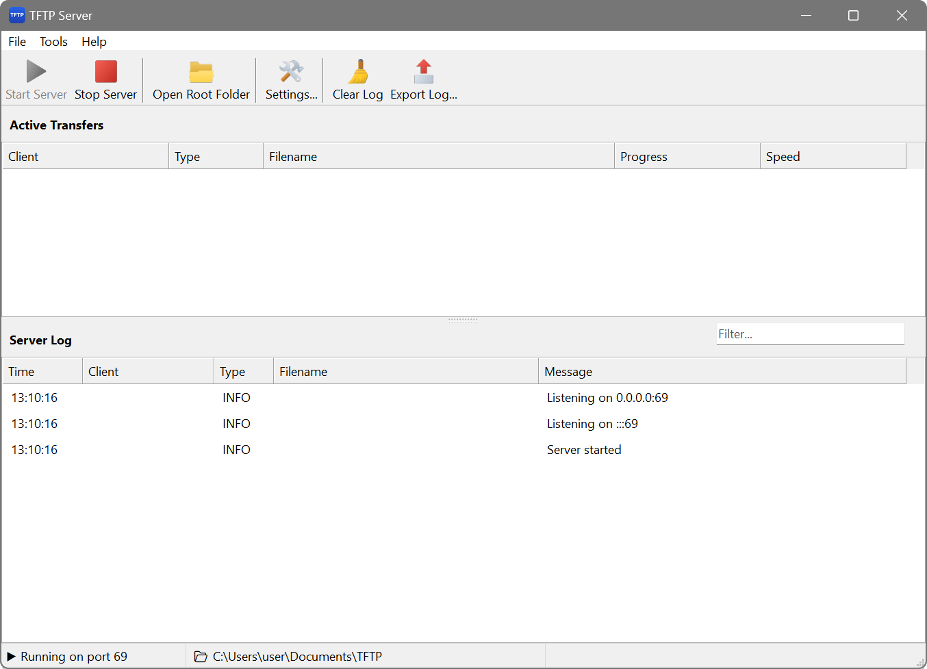

When you first start the TFTP Server application, you will see the main window:
TFTP Server main window
The main window displays:
  • Transfer list: the transfers in progress, with the client's address, the file, the direction, progress and speed.
  • Server log: server events and transfer activity as they happen.
  • Status line: whether the server is running, the port and addresses it listens on, the transfers in progress and today's completed transfers, the root folder and any problems.
Parts of the status line can be clicked: the port opens the settings, the root folder opens in your file manager, and the problems show only the warnings and errors in the server log until you click them again.

The status line shows “Running” with the port and addresses the server listens on. The server is now ready to accept TFTP requests.
